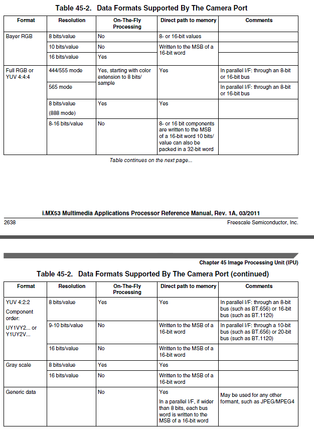

yes. but make sure that when acting in 8bit mode, P15~P8 would be used.
please refer to the sentences in RM:
"Each value can be 8-16 bit wide according to configuration of DATA_WIDTH. If DATA_WIDTH is configured to N, then 20-N LSB bits are ignored"
back to the on-the-fly processing, it's another way to process the image.
on-the-fly processing means TVADC->CSI->IC/VDI->...
direct path to memory means TVADC->CSI->SMFC->MEMORY->...

Yanfei_Sun
the connection is correct.
on-the-fly processing means the data is not put into memory but directly to post processing or rendering module. We are using the different version of RM I cannot find the table 45-2 you mentioned. it's better you can post an image for the table.

IvanMakarov
Another question about CSI:
For instance I connect ADV7180 to CSI0, and data bus goes like:
P0  ->  CSI_DAT12
P7  ->  CSI_DAT19
Is that correct?
Another question: what does it mean "On-the-fly processing" (Table 45-2 in Reference manual)
Does "No" means, that image projection will not ne avaiable without writing data on RAM?

Yanfei_Sun
For CSI the MSB is CSI0_DAT19. TVDAC_COMP is connected to GND with a 0.1uF capacitor
