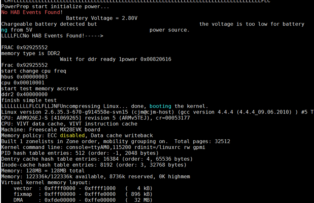

bruce_chen
1.I am use BitInit.exe burn OtpInit.sb and the bit_setting.txt like below
     *chip-family-mx28*
     lock_rom0 = true
     lock_cryptodcp = true
     lock_cryptodcp_alt = true
2. useing Mfgtool programming updater_ivt.sb, the imx28 serial port output
3. The display event code like below:
typedef hab_status_t hab_rvt_report_event_t (hab_status_t, uint32_t, uint8_t* , size_t*);
#define HAB_RVT_REPORT_EVENT (*(uint32_t*) 0xFFFF8B18)
#define hab_rvt_report_event ((hab_rvt_report_event_t*)HAB_RVT_REPORT_EVENT)
hab_status_t g_hab_status;
void display_event(uint8_t *event_data, size_t bytes)
    uint32_t i;
    if ((event_data) && (bytes > 0))
        for (i = 0; i < bytes; i++)
            if (i == 0)
                printf("    0x%02x", event_data[i]);
            else if ((i % 8) == 0)
                printf("\n    0x%02x", event_data[i]);
            else
uint8_t      event_data[128];
void get_hab_status(void)
        uint32_t     index = 0;
        size_t       bytes = sizeof(event_data);
    uint8_t      no_events = 1;
    while ((g_hab_status = hab_rvt_report_event(HAB_FAILURE, index, event_data, &bytes))
        == HAB_SUCCESS)
        //no_events = 0;
        //break;
        no_events = 0;
        printf("\n");
        printf("--------- HAB Event %d -----------------\n", index + 1);
        printf("event data:\n");
        display_event(event_data, bytes);
        printf("\n");
        index++;
    if(no_events)
        /* Including input_ivt here is simply to force the linker to include
         * it in the image and do not optimize it away.
        printf("No HAB Events Found! %d\n", input_ivt.ivt.reserved2);
    else
        printf("Some HAB Events Found!\n");
I don't know why is No HAB Events Found?    Is my OtpInit.sb not enable HAB?     thanks

Yuri
  perhaps, the following helps.
Q&amp;A: How to enable MX28 HAB Problems?
