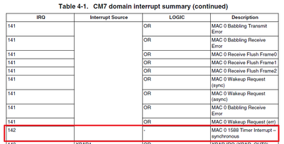

    Hi,I'm so sorry to disturb you again after such a long time.Continuing with the previous description.
    Is the interrupt corresponding to 142 in the interrupt vector table a comparison interrupt of ptp1588 timer? What does the explanation of MAC 0 1588 Timer Interrupt synchronous correspond to 142 in the interrupt vector table in the figure?

Hi @Haha_plum ,
Have you referred to enet_txrx_ptp1588_transfer demo in SDK? ENET_Ptp1588IRQHandler() and TimeStampIRQHandler() has been enabled in ENET_Ptp1588ConfigureHandler().
ENET_EnableInterrupts(base, (ENET_TS_INTERRUPT | ENET_TX_INTERRUPT));
The  ENET_TS_INTERRUPT is ((uint32_t)kENET_TsTimerInterrupt | (uint32_t)kENET_TsAvailInterrupt).
These two source will generate interrupt and call ENET_Ptp1588IRQHandler(). And ENET_Ptp1588IRQHandler will call TimeStampIRQHandler().
ENET module has 4 TCC register will has compare function.When the ENET free-running counter value matches the output compare reference value in the TCCRn register, the corresponding flag, TCSRn[TF], is set, indicating that an output compare has occurred. The corresponding interrupt, if enabled by TCSRn[TIE], will be generated. Please see 60.3.8.6.2 in reference manual.
