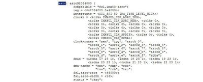

I am currently facing a strange problem with the SPDIF output on IMX6ULL.
Instead of being 44,1kHz, my AP shows it as 44,8343kHz. This causes some applications to stutter.
Apart from that, SPDIF does work.
Any ideas ?
Thanks!

Hi Noel
what bsp used in the case, one can look at i.MX6ULL spdif example on
https://source.codeaurora.org/external/imx/linux-imx/tree/arch/arm/boot/dts/imx6ull-14x14-ddr3-arm2....
igor

Hi Igor,
im currently using the 5.4.70_2.3.0 BSP.
I implemented SPDIF as described - that is not the problem.
The problem is -as I mentioned- that SPDIF works, but the sample rate is not right

carotte
The SRC is not used.
The test failed as described....

igorpadykov
this may be the reason, may be recommended to port asrc using below example
igor

carotte
could you please elaborate on what this example is supposed to show ?
in that device tree I see no reference at all to SPDIF or ASRC, apart from the pin config for SPDIF.

igorpadykov
it is in "imx6ull.dtsi" included in that example (imx6ull-14x14-ddr3-arm2.dts) :
https://source.codeaurora.org/external/imx/linux-imx/tree/arch/arm/boot/dts/imx6ull.dtsi?h=imx_4.19....
igor

carotte
The ASRC and SPDIF parts of this device tree are identical to mine.
In the 5.4.7 BSP, this has moved to the 6ul dtsi. The SPDIF part was omitted in this BSP and added by patch.
The ASRC part has not changed.
So this can't be the reason either.
Unless there is some other configuration that needs to be done.
