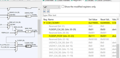

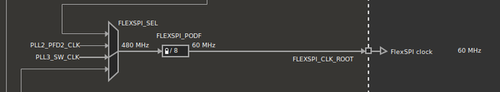

In the clock tool I can configure the clock to 133 MHz
I want to use it at 60 MHz
Can you please tell me how to adapt the code in app.h to use the flexspi clock at 60 MHz?
    CLOCK_InitSysPfd(kCLOCK_Pfd3 ???, ???); // No clue what I fill in here
    CLOCK_SetMux(kCLOCK_FlexspiMux, 0x2); // Should this be 0x3???
    CLOCK_SetDiv(kCLOCK_FlexspiDiv, 8);

I think I figured it out
can you confirm that this is correct?
#if defined(flash_60MHz)
    CLOCK_InitSysPfd(kCLOCK_Pfd3, 24);    /* Set PLL3 PFD2 clock 480MHz (I guess??) . */
    CLOCK_SetMux(kCLOCK_FlexspiMux, 0x1); /* Choose PLL3 PFD2 clock as flexspi source clock. */
    CLOCK_SetDiv(kCLOCK_FlexspiDiv, 8);   /* Divide 480 by 8 to get flexspi clock 60MHz. */

2,408 Views
bp1979
Senior Contributor I
Oh.... my.... god... really?
I will test this this evening. But the traditional off-by-one is kind of painful in this case ;-).
Thx, this makes perfect sense anyway

bp1979
Right, I noticed that it indeed super flexible, which makes it pretty complicated. But I am hopeful again that things might finally come together now.
Just to be clear: we can't use DQS (we assigned that pin to something else in our hardware design, unfortunately), so I need to get flash running at max 60MHz. And I just learned from you that I THOUGHT I was running the flexspi clock at 60MHz, but I wasn't.
I hope that this solves some other weird behavior I am experiencing with my second flash. I will let you know
