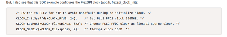

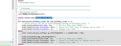

But, I also see that this SDK example configures the FlexSPI clock (app.h, flexspi_clock_init):
    /* Switch to PLL2 for XIP to avoid hardfault during re-initialize clock. */
    CLOCK_InitSysPfd(kCLOCK_Pfd2, 24);    /* Set PLL2 PFD2 clock 396MHZ. */
    CLOCK_SetMux(kCLOCK_FlexspiMux, 0x2); /* Choose PLL2 PFD2 clock as flexspi source clock. */
    CLOCK_SetDiv(kCLOCK_FlexspiDiv, 2);   /* flexspi clock 133M. */
Can I leave the FlexSPI clock running at 133 MHz when flash is supposed to run at 60 MHz?
Or do I need to reconfigure clocks to get a FlexSPI clock frequency that is exactly 60 MHz?
Does the FlexSPI clock frequency need to correspond with the configured flash speed?

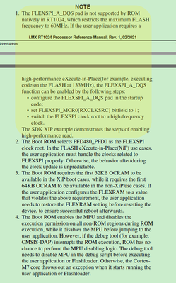

Hi @bp1979 ,
  Please check the content from the RT1024, you will get the answer:
ROM didnt use the DQS, so the FCB limit to the 60Mhz.
But in the code, if you enable the DQS, then you change to more than 60Mhz, it's OK to use.

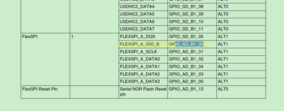

So you say that settings MCR0[RXCLKSRC] = 0x0 will set the FlexSPI clock in 60 MHz?
So what does this do then:

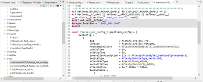

kerryzhou
Hi @bp1979 ,

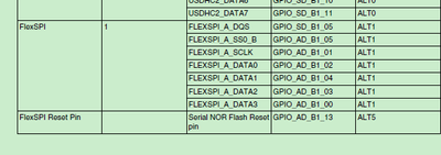

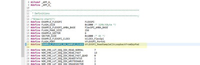

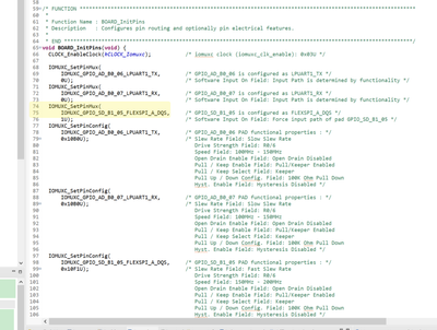

  You misunderstand me, let me share more details.
1. 60Mhz,  MCR0[RXCLKSRC] = 0x0, is the default for the XIP FCB.
Reason: The FLEXSPI_A_DQS pad is not supported by ROM
natively in RT1024, which restricts the maximum FLASH
frequency to 60MHz.
2. To your mentioned, it is the SDK flexspi_nor_polling_transfer project.
In the code, you can use higher than 60Mhz if you init the DQS pin, please check the pin_mux.c, you will find it.
Then, you can use the code to set more than 60Mhz:
All the reason is determined by you define the DQS pin or not.
Wish it helps you!
