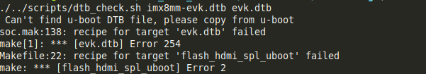

I have successfully ported u-boot to my custom board which is based on iMX8M-Mini EVK.
I have managed to build u-boot and generate required files for building flash.bin.
- U-Boot:
  u-boot-nodtb.bin
  u-boot-spl.bin
  U-Boot DTB file (e.g. imx8mm-<custom-board>.dtb)
wrf to above list, I have added custom board's dtb file.
Now while running,
make SOC=<SoC Name> flash_hdmi_spl_uboot
I running into error as below,
What am I missing, do I need to add custom rule in soc.mak for my custom board.

May I ask which version of imx-mkimage are you trying to use?
Also, I would recommend using the same name as in the soc.mak for the images needed.
imx8mm-evk.dtb
If you plan to use a custom name, you may need to customize the soc.mak.
Aldo.

Am using imx version 5.4.24_2.1.0..

Thank you for sharing, then please try with my suggestion above and let me know if this does not work.
