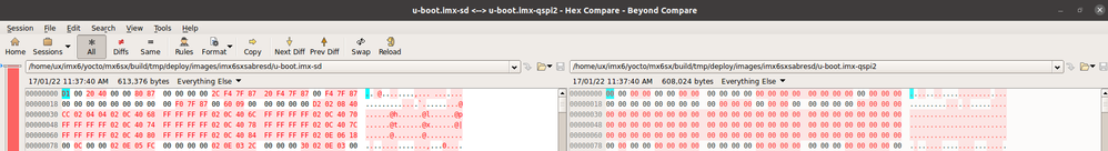

    Recently we've built the U-Boot for i.MX 6SX SABRE-SD's QSPI boot medium. When we try to sign the image for HAB Authentication, we ran into the problem of missing header information.
    We've successfully verfied HAB Authentication earlier for SD Card boot medium. Hence the header comparison of the QSPI vs SD Card U-Boot is shown below:
    So our questions are summarised below,
  1. Is HAB authentication for QSPI?
  2. How could we add the missing imx header information for the QSPI U-Boot?
  3. Is there a provision to get the header details otherwise?

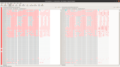

    Thanks for pointing out the NXP's reference U-Boot, we've downloaded it and tried to sign but we think "HAB" is not enabled on the shared image.
    Moreover, the imx header is agian zero on the reference image. Hence the image doesn't worked on a closed board.
Any further update would be appreciated. 

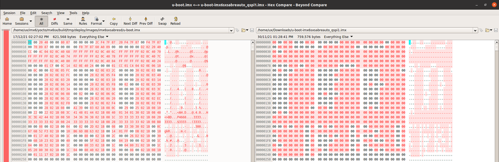

The header difference between SD and QSPI U-Boot is given in the following picture.
Thanks in advance.

utkarsh_gupta
Usually the qspi image contains configuration info in first 0x1000 (0x400) of the image. Thus the IVT header resides at 0x1000. Please adjust the CSF accordingly.
for ex:
Blocks = <address> 0x1000 <size>-0x1000
Make sure the address is pointing at start of IVT and not start of image.
