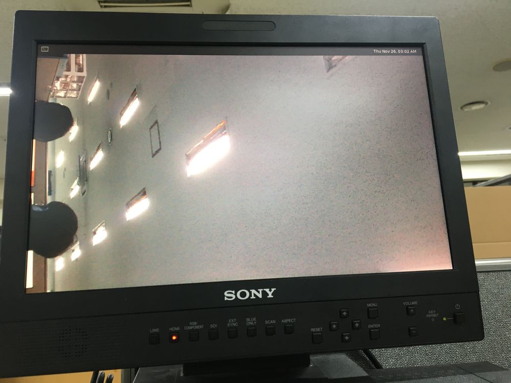

hi guys,
I am checking camera demo app in imx-gpu-sdk and using kernel 4.14.98.2.0.0
I believe imx-gpu-sdk is late version, by the way, camera vew is not correctly working always "BLUE" screen.
Do you have ideas why below screen is displayed?

Hi guys,
Thank you for answering,
When I found something wrong in shader.frag and vert file, Camera preview worked, but I think it is not good for color of camera view that seem to be much of red color: see below caputured camera veiw:
Where should i change part for fixing color issue?
By the way, when i ran, "mx8_v4l2_cap_drm.out -cam 1 -fmt RGBP 1080 -oh 720 200 -p" is ok and color is good.

hi guys,
Thank you for answering.
I have still a problem to display camera view using opengl, but, in case of DRM, It seems to be ok until now.
when I run "CameraDemo" in gtec-demo-framwork/DemoApps/GLES3/CameraDemo,
Camera preview seems to be much of red color(Please reference my previous post).
As you can see my captured image in previous post, you can see red color in entire display area.
what i did in cameraDemo app, I just modified some code but not change shader.frag, shader.vert.
: i have set "V4L2_PIX_FMT_XBGR32" and  one channel for video channel.
If you can't understand my issue, please tell me more detail what you cant' understand?

joanxie
it seems that gtec-demo-framework is the third party opensource, we don't offer support debuging this, suggest to use gpu demo under /opt/imx-gpu-sdk/
