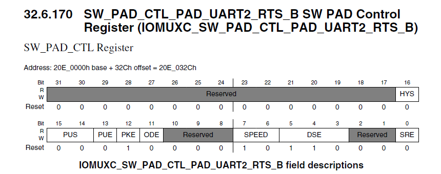

I found some sample code use 0x100b1 to configure the spi pins while some use 0x10b1. which one is correct? Thanks.
MX6UL_PAD_UART2_RTS_B__ECSPI3_MISO 0x100b1 /* MISO*/ MX6UL_PAD_UART2_CTS_B__ECSPI3_MOSI 0x100b1 /* MOSI*/ MX6UL_PAD_UART2_RX_DATA__ECSPI3_SCLK 0x100b1 /* CLK*/ MX6UL_PAD_UART2_TX_DATA__ECSPI3_SS0 0x100b0 /* CS*/
MX6UL_PAD_UART2_RTS_B__ECSPI3_MISO 0x10b1 /* MISO*/ MX6UL_PAD_UART2_CTS_B__ECSPI3_MOSI 0x10b1 /* MOSI*/ MX6UL_PAD_UART2_RX_DATA__ECSPI3_SCLK 0x10b1 /* CLK*/ MX6UL_PAD_UART2_TX_DATA__ECSPI3_SS0 0x10b0 /* CS*/

It is 0x10b1, you can see the register in the RM.
