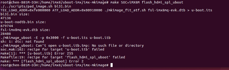

HI all:
This error occurred while compiling flash.bin for my own board
I passed both the DDR calibration and the stress test then generate the lpddr4 times.c file
I copied the file as required by i.MX Linux® User's Guide5.13
Is this error missing u-boot.itb?
Where does the u-boot.itb file come from?

for new memory one can follow Chapter 4 How to bring up a new MX8MSCALE board
p.13 MSCALE_DDR_Tool_User_Guide.pdf included in
i.MX8 MSCALE SERIES DDR Tool Release (V2.10)
also detailed build steps can be found on
https://developer.solid-run.com/knowledge-base/i-mx8m-atf-u-boot-and-linux-kernel/
