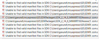

I noticed that there was an update to the SDK, the most current version is now 2.14
However, when I refresh the SDK repository through MCUXpresso, it does not see the most up to date version (it only shows 2.13, and says that is the most up-to-date).
When I try and import the zip I built of it, I get many errors. Most of these errors are "Unable to find valid manifest file"
Is this normal?

Hello @GUnderdown,
As you mentioned a newer SDK version was released. Unfortunately, you could not use it in latest MCUXpresso IDE or ConfigTools version, because the new SDK version v2.14.0 is for upcoming MCUXpresso ConfigTools v14.
Talking with the development team, they plan to release the new MCUXpresso ConfigTools v14 very soon.

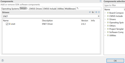

Hello @GUnderdown,
Could you please try adding the drivers as follows?
  • In Peripherals, click on Peripheral drivers (Device specific)
  • In the new window, click on Open SDK components manager.
[MCUXpresso IDE -> ConfigTools -> Peripherals]
  • Now on Drivers, type ENET and COMMON drivers, check the boxes, and click on OK.
[Manage SDK components for project MIMXRT1024_Project]
If that does not work, could you please take pictures of your ConfigTools configuration, the warnings, and the build errors?

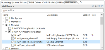

 Even though is not recommended to use older SDK versions, we tested the SDK_2.8.0_MIMXRT1024xxxxx and it includes the MDIO drivers. So might be a good idea, either to use the MDIO drivers for there to your own project by copying and pasting them, or to use the older SDK version (which as we mentioned before it is not recommended). You could download the SDK here: Welcome | MCUXpresso SDK Builder.
If you are going to use SDK_2.8.0_MIMXRT1024xxxxx, you may encounter a new warning, similar as the one you are obtaining in the newest SDK, but could be fixed by following the next steps:
  • Return to the workspace.
  • Right click on the project and go to SDK Management -> Manage SDK Components
[MCUXpresso IDE -> SDK Management]
  • Look for Middleware -> Network -> lwIP TCPIP Networking Stack, and check lwIP_enet_ethernetif_kinetis box
[MCUXpresso IDE -> Available SDK components]
  • Click on OK. A new window will open, click on Yes, and wait until the SDK component is added.
