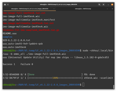

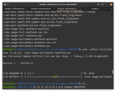

  To prevent the problem is only on eMMC, I also tru to use uuu in both 6.1.22/6.6.23 to test:
In 6.1.22, I can do it without problem to flash a sd card:

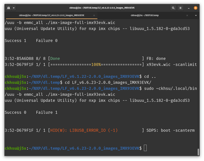

However, when using 6.6.23, I fail to do it with the command, and the error is same as doing in eMMC, therefore I think the problem is NOT solved even using uuu:

  I don't think the uuu can solve the problem. I can use uuu to download the 6.1.22 but fail after this version.
  This is how I can download thru uuu for 6.1.22.
And for the same way for uuu test on 6.6.23
You can see the error still happen.
