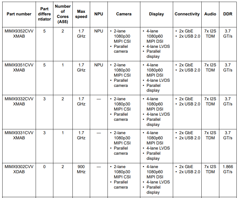

Hi team
I'm using iMX93EVK with imx9352, and the register field FLEXIO.VERID.FEATURE = 0003h,which means supporting all functions. An iMX9302 will be used in my customer board, and I'm not sure if all flexIO functions availble just like imx9352. Please let me know the configuration of flexIO in both imx9302 and imx9332. Thanks!

JosephAtNXP
Thank you for your interest in NXP Semiconductor products,
The differentiators for those parts are below, their FLEXIO number and its functionality is not affected, you may proceed in your design with the same config.
