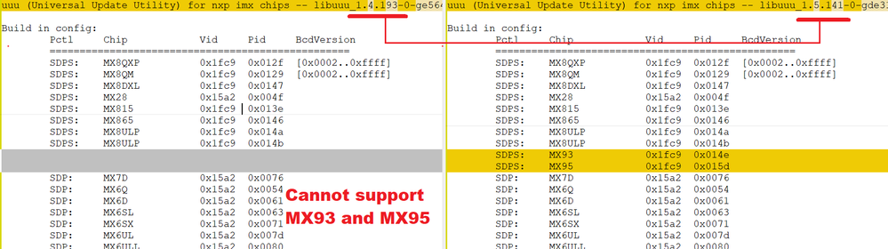

Hi! I'm trying to burn the stock imx linux image on the iMX93 EVK board with the uuu tool. So far I've downloaded the L6.1.36_2.1.0_MX93 zip file with the image and installed the uuu utility with apt.
I've figured the correct uuu command is:
sudo uuu LF_v6.1.22-2.0.0_images_IMX93EVK.zip/uuu.auto-imx93evk
This output below:
uuu (Universal Update Utility) for nxp imx chips -- lib1.4.193
Success 0 Failure 0 Wait for Known USB Device Appear...
Prep 1/ 0 [=================100%=================] Http Download\Uncompress
And gets stuck forever. It seems that my imx93evk board doesn't get recognized as a USB device no matter how hard I try and I've tried multiple SW1301 configurations, the Serial Downloader (0011) configuration as well. Do you know what shall I do in this case? Is it possible that the board is broken or fried somehow? It does light up and with images flashed from Yocto builds directly on an SD card I had no problems booting up.

If you add -v to uuu, you will see the chip support in the current uuu version.
And you can use uuu -lsusb if the hardware is really connected. Or use like windows device manager to check it.
So, for your log, you are using 1.4.193 could not support i.mx93.
Please download new one.
https://github.com/nxp-imx/mfgtools/releases/tag/uuu_1.5.141

Indeed, getting the latest version helped. Thanks! It did work!
