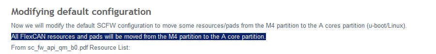

Hi Joakim
flecan may be used by m4, one can try steps described in
System Controller Firmware 101 - Resource management service
SCFW Porting Kit
igor

joakim_hesselgr
By doing this fix it did not help since as can be seen in the bootlog we already had access to the CAN on the A35. I tried it out and I have attached these bootlogs. Bootlog_CAN_Added is where I just use the default with alt_config enabled which shows it does not own CAN while in the Bootlog_CAN_Removed I have done the fix shown in your link which shows that CAN now is owned but it still does not show the device after I modprobe flexcan.
