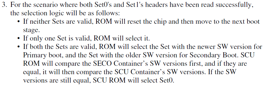

As per your answer if it is secondary firmware corresponds to Image container set 1. Then as per FuseMap section Table 7.1
The Firmware2_startingPage written to FCB should have the offset corresponding to this fuse information. But kobs-ng has no idea about this and it calculates the Firmware2_startingPage based on stride size.
Also as per 5.9.3 Imager Container Set selection bullet point 3
So i feel what kobs-ng write as a Firmware2 is not same as Secondary Image Container set.
I am afraid it is confusion. "Firmware1_startingPage" does not relate to
Image Container Set and its fuse.
