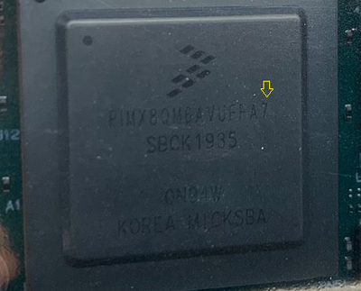

iMX8QM part number printed on chip, can't exact match it ..

This is what is printed on my SoC:
This is NXP' product selector:
https://www.nxp.com/products/product-selector:PRODUCT-SELECTOR#/category/c731_c380_c127_c1430
Can't see what that "7" at the end is... Does it matter ? What is the number 7,  datasheet has no number option at the end:

Dear @dry You do not need to care about it, as the product you mention is not our production product, it is for sample. So that you can not see the details in our datasheet.

Hello @Rita_Wang
Thank you for the info, question:
do we need to worry about using the sample and not production version ...?

I think you can use it, but for product use recommend you to use the production product in our website.
