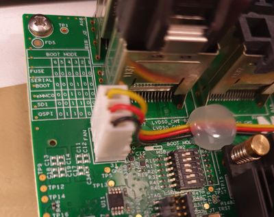

jishin42
sudo dd if=./fsl-image-multimedia-imx8mqevk-20201009141009.rootfs.wic of=/dev/sdc bs=1M conv=fsync
The jumpers on the card are OK as the binary image provided by NXP boots fine (3=ON, 4=ON, other=OFF)

7,406 Views
Zhiming_Liu
Change SW801 to switch the board back to 1100 (SD boot mode),1=ON,2=ON,3=4=OFF
7,398 Views
jishin42
According to the picture, there is no reason to change the switches. Furthermore, the iMX boots correctly when I use the NXP binary file available on the MEK main page from the NXP website.
Never the less, I tried the proposed switch option, but it still does not boot...
