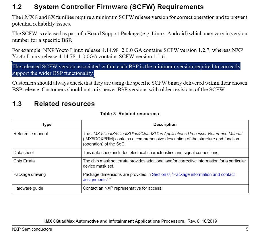

Hi Stuart
general way to build SCFW with enabled Debug Monitor is described on
System Controller Firmware 101 - Resource management service
However depending on SCFW version there may be differencies, for example
described in Chapter 4 attached SCFW Release Notes version v1.3.0 used with
 L4.14.98_2.3.0
Note SCFW version should be aligned with Linux version as described in
i.MX 8QuadMax Automotive and Infotainment Applications Processors  :
Also may be useful
Normal and Secure Debug for i.MX8/8X Family of Applications Processors
https://community.nxp.com/docs/DOC-343054
