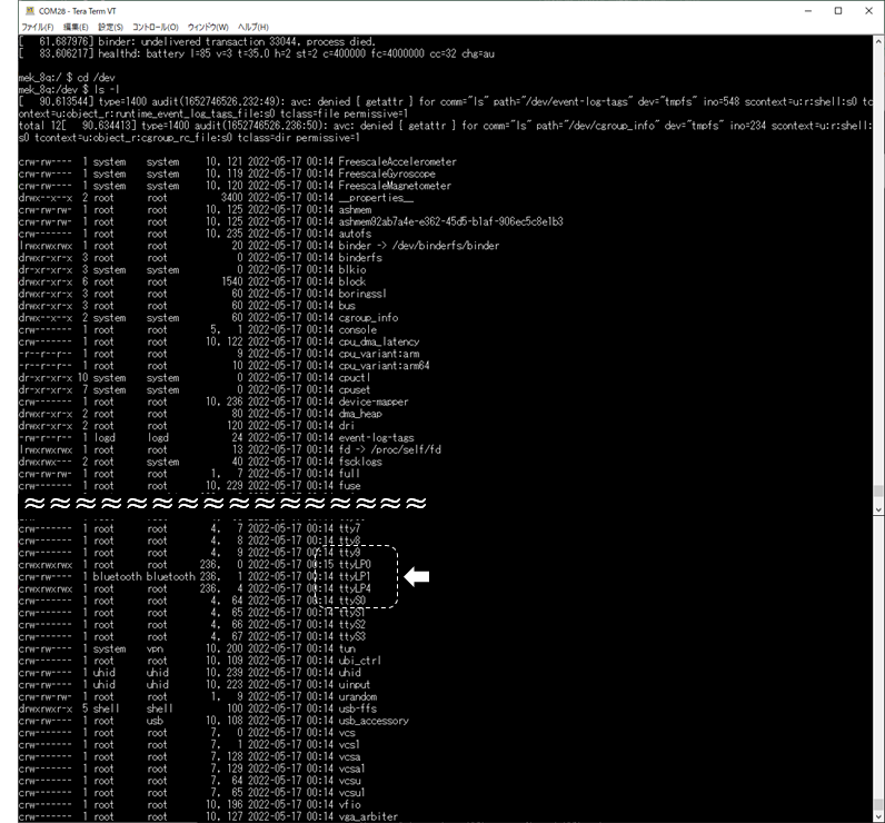

Hi, all.
I want to know how to use LPUART2 from coreA.
By default, LPUART2 is assigned to the coreM4, and I think that access is prohibited from the coreA.
I used scfw_tcm.bin which was built by changing the SCFW setting.
・board.c (/imx-scfw-porting-kit-1.12.1/src/scfw_export_mx8qm_b0/platform/board/mx8qm_mek)
- changed the following code.
/* List of pads */
static const sc_pad_t pad_list[6U] =
    RM_RANGE(SC_P_M41_I2C0_SCL, SC_P_M41_GPIO0_01),
    // RM_RANGE(SC_P_UART0_CTS_B, SC_P_UART0_RTS_B),
    RM_RANGE(SC_P_FLEXCAN0_RX, SC_P_FLEXCAN2_TX),
    RM_RANGE(SC_P_QSPI0A_DATA0, SC_P_COMP_CTL_GPIO_1V8_3V3_QSPI0)
Also, I made the following changes.
environment
・Android-11.0.0_2.6.0
・MCIMX8QM-CPU + MCIMX8-8X-BB
changes
・init.rc (/device/nxp/imx8q/mek_8q)
- Added the following code before "on boot".
chmod 0777 /dev/ttyLP2
・imx8qm-mek.dts (/vendor/nxp-opensource/kernel-imx/arch/arm64/boot/dts/freescale)
&lpuart2 {
pinctrl-0 = <&pinctrl_lpuart2>;
status = "okay";
However, LPUART2 is not enabled.
The ttyLP2 device file is not added.
What other settings do I need?

I was able to enable ttyLP2 with the following changes:
1.
Change the boot setting
BoardConfig.mk(/device/nxp/imx8q/mek_8q)
 Added the following code.
    # SELinux
    BOARD_KERNEL_CMDLINE += androidboot.selinux=permissive
2.
Change the device tree.
imx8qm-mek.dts(vendor/nxp-opensource/kernel_imx/arch/arm64/boot/dts/freescale)
 Changed the following code.
    &lpuart2 {
        status = "okay";
imx8qm-mek-rpmsg.dts(vendor/nxp-opensource/kernel_imx/arch/arm64/boot/dts/freescale)
    &lpuart2 {
        status = "okay";
    &uart2_lpcg {
        status = "okay";
3.
Remove pin assignment of M4 core
・Base on board-imx8qm.c (vendor/nxp/fsl-property/uboot-firmware/imx8q), change as follows.
    /* Create M4 1 partition */
    if (rm_is_resource_avail(SC_R_M4_1_PID0) != SC_FALSE)
            sc_rm_mr_t mr;
            /* List of resources */
            static const sc_rsrc_t rsrc_list[8U] =
                    SC_R_IRQSTR_M4_1,
//                  SC_R_UART_2,
                    SC_R_MU_6B,
                    SC_R_MU_7B,
                    SC_R_MU_9B,
                    SC_R_GPT_3,
                    RM_RANGE(SC_R_CAN_0, SC_R_CAN_2),
                    SC_R_FSPI_0
            /* List of pads */
・Build with gcc-toolchain and place the generated binary file in vendor/nxp-opensource/imx-mkimage/iMX8QM.
 Refer:https://community.nxp.com/t5/i-MX-Processors-Knowledge-Base/System-Controller-Firmware-101-Getting-s...
・At this time, change the name of the binary file.
Also, change the code of "scfw-tcm.bin" in the following makefile as above.
(soc.mak, android.mak, autobuild.mak, m4.mak, misc.mak)

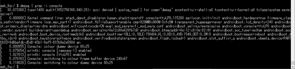

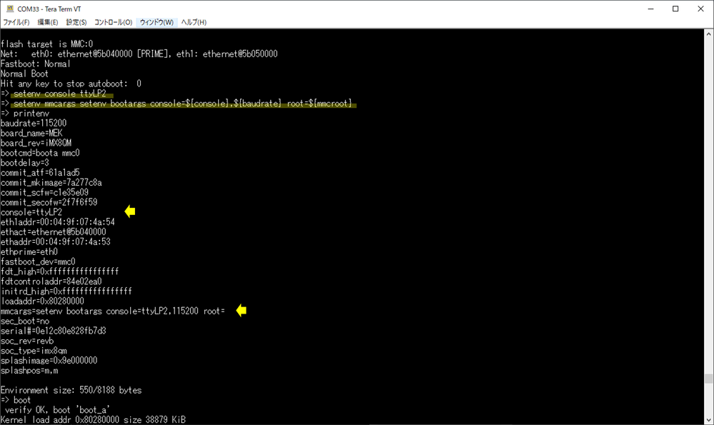

try to set this in the uboot
setenv console ttyLP2
setenv mmcargs setenv bootargs console=${console},${baudrate} root=${mmcroot}
when board boot up, use command " dmesg | grep -i console", what do you get?

@joanxie
Is this okay?
ttyLP2 is not registered yet.
