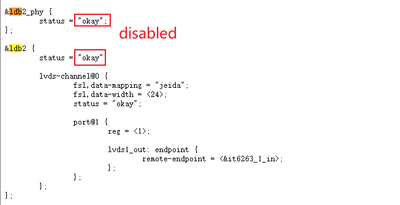

For b,  you need disable ldb2  and ldb2_phy nodes in imx8qm-mek.dts

For point b, I understood about disabling ldb2. However, at the same time, I need to enable HDMI Tx port (J6) to drive a custom display panel of 3840*1100@60. If you would require the data sheet from the LCD vendor, I can share.
