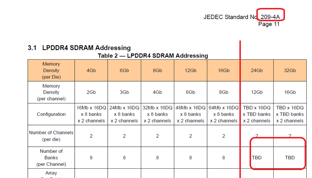

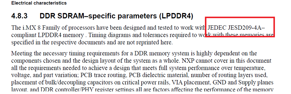

BiyongSUN
In the i.MX8QM datasheet, it already told you JESD209-4A not JESD209-4B.
It is very solid information.
Memory Density (per channel) is 8Gb. "b" not "B" in JESD209-4A.
If you check your question again, you will find your question has no enough information. number of cs? number of ddr phy? channel?
the configuration should be like 64Mb x 16DQ x 8 banks x 2 channels. Not 4GBx2, 8GBx1. that is cs, not configuration.
and if you read the ddr part datasheet, it is exactly the same as JEDEC spec. i.MX and ddr part, they all follow the spec.
