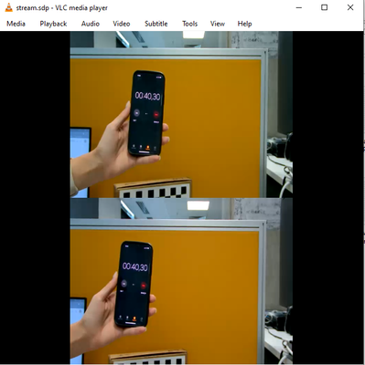

dianapredescu
Hi @khang_letruong ,
So you want a GStreamer pipeline to compose your two camera streams and stream the composed data over network, right?
gst-launch-1.0 imxcompositor_g2d name=comp \
sink_0::xpos=0 sink_0::ypos=0 sink_0::width=640 sink_0::height=480 \
sink_1::xpos=0 sink_1::ypos=480 sink_1::width=640 sink_1::height=480 \
! queue ! videoconvert ! v4l2h264enc ! rtph264pay config-interval=1 pt=96 ! udpsink host=169.254.235.127 port=5000 \
v4l2src device=/dev/video2 ! imxvideoconvert_g2d ! video/x-raw, width=640, height=480 ! queue ! comp.sink_0 \
v4l2src device=/dev/video3 ! imxvideoconvert_g2d ! video/x-raw, width=640, height=480 ! queue ! comp.sink_1
On the client side, the output, with a latency:
Is this helpful?
Diana

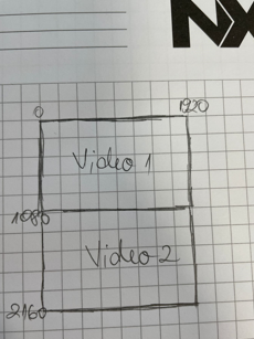

dianapredescu
Khang,
I was thinking, if I compose two 1920x1080 (one above the other)  before encoding and streaming it over the network, I would have a window of 1920x2160 resolution, right? Were you saying that I can rescale the output window?
Diana

dianapredescu
Dear @khang_letruong ,
sorry for mixing things. No, in the case I previously tested with two 640x480 stream, I had on client side a 640x960 video window. The 1920x2160 window came into the discussion from the scenario of using two 1920x1080 video streams. (This is what I'm currently investigating  - composition of 2 FHD streams)
In the latest BSP I've seen we have modified the vpu capabilities. It looks like with the latest BSPs one can encode more than 1920x1080 with v4l2h264enc. ( https://github.com/nxp-imx/linux-imx/blob/lf-5.15.y/drivers/mxc/hantro_v4l2/vsi-v4l2-config.c#L755 )
So I would understand that I should be able to encode 1920x2160 with one instance, right?
Diana

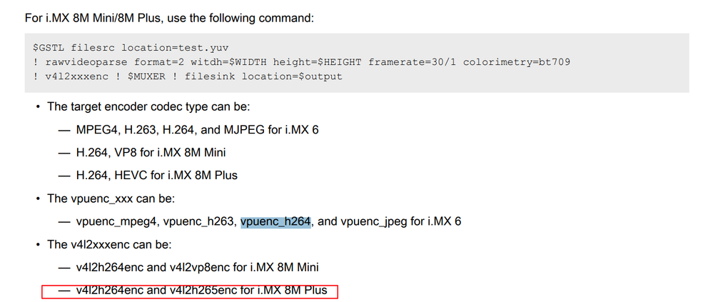

Senior Contributor III
Hi @dianapredescu ,
Thanks for your thorough explanation. Another confusion was v4l2h264enc vs vpuenc_h264 as per following question :
Thanks for your suggestion. It is nearly what I need. I would like to know if vpuenc_h264 could be used instead of v4l2h264enc  and the resolution would be 1440x1080 or 1920x1080 instead of 640x480, please ?
I was always thinking that vpuenc_h264 was H264 hardware accelerated encoding element of iMX8M Plus but it turned out that it was not in following doc:
K.
13,243件の閲覧回数
dianapredescu
Dear @khang_letruong,
I understand where the confusion comes from. When we release 8MP platform, I believe vpudec and vpuenc_h264 were the only codecs we provided. They were HW accelerated. But we used those because the v4l2 software support wasn't ready for VPU decoder/encoder at that time. Now, NXP recommends using the latest VPU drivers: v4l2h264enc & v4l2h264dec.(that's why v4l2 codecs follows hantro supported resolution matrix -> max. 1920x4096 for H264 decoding and 1920x8192 for H264 encoding).
Since we are using open source v4l2 framework and we exposed the full capability, any customer can make use of it. But NXP official commitment will remain 1080p for both encoding/decoding.
