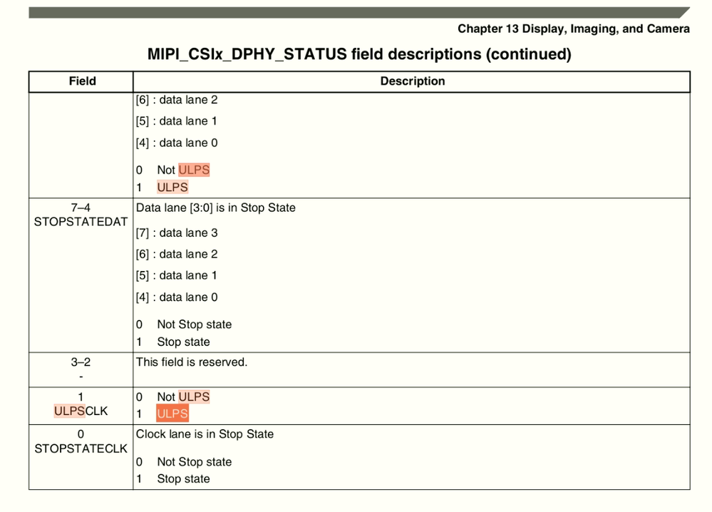

The difference I found from above was CSIS_DPHYSTATUS[20] = 0x000000e2 when the issue happened, otherwise CSIS_DPHYSTATUS[20] = 0x000000f1 for normal streaming. And the change seems to relate to the ULPS state :
Khang

Note as far as I understand (can't find any authoritative detailed docs generally available on either CSI2 or the NXP IMX8MP CSI2/ISI/ISP implementation), the CSI2 clock can be operated in a constant clock mode or in a lower power clock on/off mode where it goes from a low power non clocking state to a high speed clock state only when data is being sent (ie not during vertical/horizontal sync and general dead time).
The NXP CSI2's CSIS_DPHYSTATUS register will change its data lane and clock status bits live as the stream runs. So you only take a particular sample and need to repeat reading the register to see what states it goes through.
In my case it looks like the TP2855 is sending its clock in constant mode. When running, if I sample the CSIS_DPHYSTATUS every 1ms and list the different values obtained when the system is showing video (I have a simple 'C' program), I see only 0x000000F0 and 0x00000000. So the clock is not seen to enter the stopped or low power states but the data pairs are going from HS live to stopped. When my system is not showing video (when it should be) I see only 0x000000F1 and 0x00000001. So the clock is only in the stopped state but data pairs are running fine.
The HSSETTLE and CLKSETTLECTL as set by the DTB's mipi_csi_[01] csis-hs-settle and csis-clk-settle params appear to set the hardware to be able to determine the LP11 to LP00 state change that occurs when a clock or data pair transitions from a low power state to high power high speed mode. I don't know what these settings should be set to for the IMX8MP (NXP where is this info ?), I saw info for the IMX7 and there was a table for these values based on the high speed clock rate in use and I have been using that.
In your case, as a complete random comment from just two samples, I notice the clock appears to be going from stopped to running modes so is probably a low power/high power clock. But I note that in your problem state not all of the data pairs enter the stopped state at least at the time of the sample.

I think I have worked around my issue. The TP2855 appears to send a constant CSI2 clock. If when the video is not working I tell the TP2855 to set the clock into a stop state and then run state again the video then runs fine. I am guessing here but what I suspect is:
1. When gstreamer/kernel initialises the video stream, the TP2855 is being initialised first and starts the CSI2 clock with appropriate LP00 -> LP11 -> LP00 transition once its PLL has become stable. However I suspect, depending on various timings the CSI2 interface may be initialised a bit later sometimes and the Samsung CSI2 hardware does not notices the LP00 -> LP11 -> LP00 transition as a clock start transition.
2. The Samsung CSI2 IP block hardware appears to require the LP00 -> LP11 -> LP00 transition to determine a high speed clock is present which is ok when you are using a CSI2 source that provides a low-power/high-power switching clock source but can be an issue if the CSI2 has a constant high speed clock as in my case.
NXP can you confirm this please and if there is a mode for the Samsung CSI2 IP block to work well with constant CSI2 clock sources ?
I will look at V4L API functions for the front end driver that can be used to "start the video stream" after the hardware pipeline is up and running where I can get the TP2855 to restart its CSI2 clock  or alternatively add a TP2855 call that the user level software can use if no video stream is present. Or maybe get a vertical sync interrupt from the TP2855 to instigate a clock restart on each frame.
I may have hijacked your thread on this as my issue is likely to be different from yours, but I suggest you check that the CSI2 CSIS_DPHYSTATUS register is indicating that all data pairs and clock pair are transitioning from Stopped to running states and none are stuck in the stopped state. At least that should indicate that the front-end to CSI2 data stream appears to be working when your video stream has locked up.

Thanks for sharing your experience. It turns out that the problem on my EVK was due to bad miniSAS cable. I changed the cable and it worked much better on that EVK board. I'm still investigating the issue on the 2nd production lot with commercial-grade rev.A1 CPUs.
