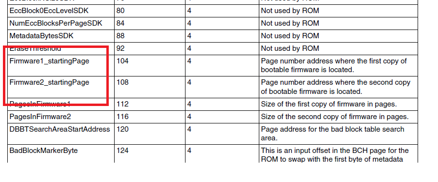

Hello everyone,
we are working with iMX8MP at a custom board with 1GB NAND storage.
Trying to face a possible uboot corruption we thought about the chapter "6.1.6 Boot Image" of the Reference manual, where it states that two booting images can be stored on memory in order to overcome a possible boot image corruption.
I've been able to test this feature booting from an SD by just burning the "flash.bin" file at SD offsets: 32K and 4M. Once done that, if we erase the first uboot, iMX8M jumps directly to the 4M offset and run the secondary image.
Now I'm trying to reproduce this behaviour from the NAND memory but I find no way to do it.
Is it even possible?
Any clue, tutorial or link that might be helpful?
Thanks in advance!

kobs-ng  could write two copies for firmware(bootloader). it is default.
since uuu 1.3.82 supports build-in script for nand "-b nand " with need nandbcb in u-boot, which does the similar as the kobs-ng.
