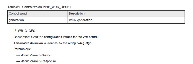

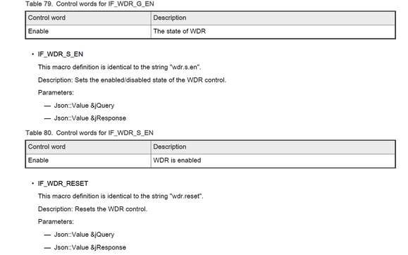

refer to the ISP Using V4L2 Interface User Guide,
maybe you can double check these control words to disable it

Hi @joanxie ,
Thanks for your reply. Do you mean that I could use the v4l2-ctl command to control this WDR3's parameters? If yes, could you give an example of the syntax, please ?
Thanks in advance and best regards,
Khang
1,672 Views
artsiomstaliaro
Example you can find in source code of vvext tool
