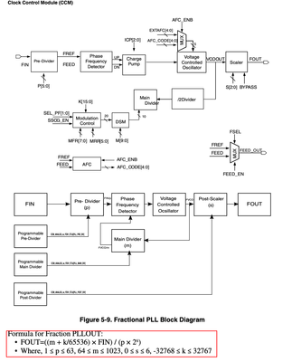

I am still being stuck with the booting from SD card. Therefore, I would like to double-check if I would need to add support for the clock of the used DDR4's PLL in SPL code as in your tutorial, please ? Please help me about how to identify the PLL dividing parameters such as m, p, s, k as well!

I think I found how to identify the PLL dividing parameters such as m, p, s, k from the following sharing : https://community.nxp.com/t5/i-MX-Processors-Knowledge-Base/iMX-8M-Mini-Register-Programming-Aid-DRA...
However, I use freq setpoints 3200 and 1066 which are already supported by the i.MX u-Boot so I might not need to customize the PLL parameters :

The PLL Formula and parameters range are descirbed in CCM.You can run the python program to get the correct parameters:
for p in range()
 for ...
  for ...
   for ...
     pll = formula
     if pll= value:
       print p,m,k,s

Dear @Zhiming_Liu ,
Thanks for your reply.
By the way, what is the python program that you mentioned? Where could I find it?
Does your board can pass under the i.MX DDR Tool?
Our custom board could pass the MSCale DDR Tool v3.30. Did you mean another tool named DDR tool ?

1.You can write the python script refering the formula and parameters range.
2. Our custom board could pass the MSCale DDR Tool v3.30. Did you mean another tool named DDR tool ?
-->It's MSCale DDR Tool v3.30.
