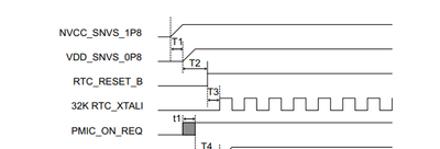

Hi Team,
Regarding the iMX8MN specifications, only typical and maximum values are provided, but there is no minimum value given.
Our PA team believes that a minimum value should be a positive number even if not specified in the specifications.

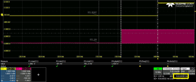

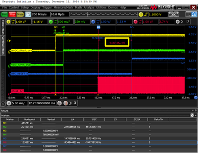

The measurement result in our device is -9.54ms, and we have verified the timing on the iMX8MNANOD3L EVK, obtaining a similar value.
Can we bypass this issue?
Our device
iMX8MNANOD3L EVK
Please advise.

The minimum value for T3 is not defined means 32K_RTC_XTALI can be earlier than RTC_RESET_B. The test result is just fine.
