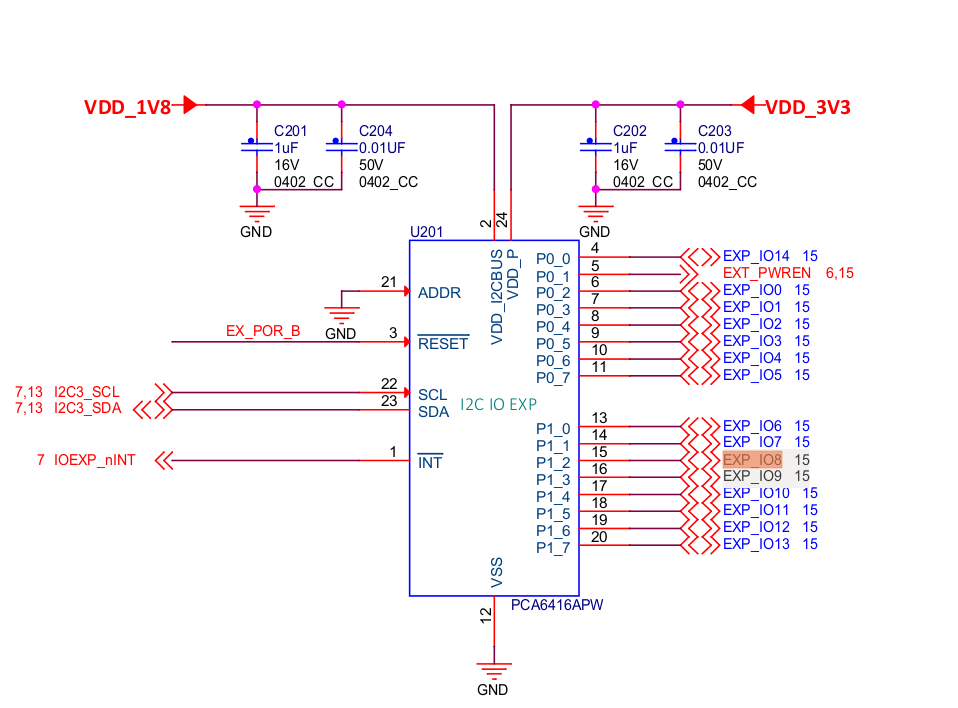

I expect to use EXP_IO8 and EXP_IO9 of PCA6416 on iMX8MM EVK as POWER-DOWN and RESET control for a camera sensor :

I always got the following error :
[    6.706860] adv7180 2-0021: request for power pin failed: -517
[    7.539305] adv7180 2-0021: request for power pin failed: -517
for the below code snippet :
        state->pwdn_gpio = devm_gpiod_get_optional(&client->dev, "pwn",
                                                   GPIOD_OUT_HIGH);
        if (IS_ERR(state->pwdn_gpio)) {
                ret = PTR_ERR(state->pwdn_gpio);
                v4l_err(client, "request for power pin failed: %d\n", ret);
                return ret;
Could someone tell me how I would be able to use the mentioned outputs, please ?

Please try the camera senor module later than  subsys_initcall.

You try you camera as module. you build the camera driver as module not build in than manually insmod.
The you try the camera senor module later than subsys_initcall. Because the gpio expander driver using subsys_initcall.

here is my suggestion.
Use the original dts.
and use the the gpio in /sys/class/gpio from use space, first to narrow down the issue.
Accessing GPIO From UserSpace - NXP Community

BiyongSUN
I gave you idea, have you tried?
It may because the gpio expander driver init later than the camera driver init.
