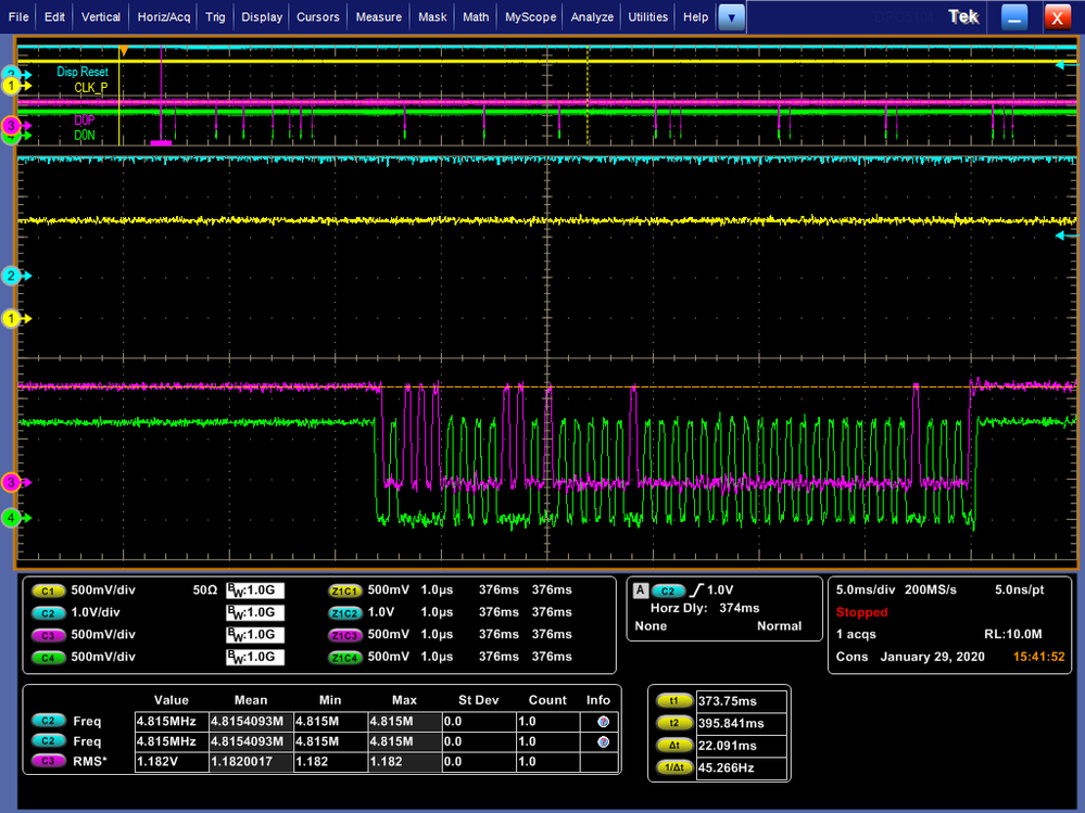

kislingera
I just made some new measurements with the working Board (which uses a SSD2828 bridge; and no iMX).
I assume that the following transmission is a standard LowPower transmission, which every MIPI device should support - and therefore also the iMX8M mini, right?
Clock should be restored by Exor-function of D0P / D0N - right? --> the measurement shows something like 7.4MHz clock frequency for this transmission.
15,935 Views

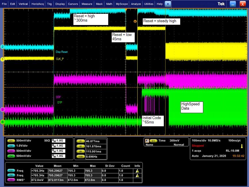

kislingera
Working on the same project, I can show this picture with another evalboard driving the discussed display. But as Pier wrote above, we need it with MIPI from imx8m mini.
Here you can see the initial code, without having signals on CLK_P (I have also measured CLK_N, but not visible here)
Please excuse the bad signal quality, but I only have one active probe.
