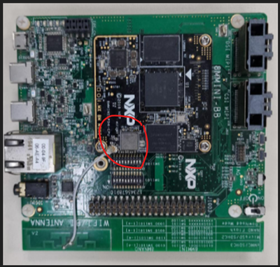

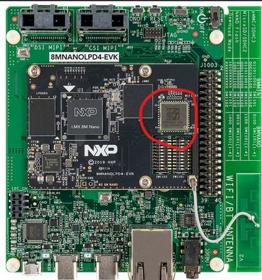

The difference is on the wifi module, please check the attached images.
Yes, the wifi works with older bsp versions but the new versions of the BSP do not support the wifi device on older imx8mm-evk.

There are two versions of the board, if you have the version with NXP wifi 88W8987 follow the instructions that I previously I purpose, if you have the old version you don´t have wifi support.
I attached the images of the two versions of the board.

I don't see any differences between the two pictures you attached, what should I be looking for? I know that WiFi has worked on this board in the past.
5,958 Views
Chavira
Hi @maffan!
