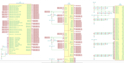

The custom board is built nearly the same as 8MMINILPD4-CPU2-DESIGNFILES except I use Samsung K4F8E304HB 8Gb LPDDR4 SDRAM. I encounter problems when I use mscale_ddr_tool _v3.30. Below are my questions.
1) The output of PMIC PCA9450A does not change after hardware_init. LX1, LX2 & LX3 are the same ~0.85V before and after I download the script. Is it correct?
2) The layout between the iMX8M Mini SoC and LPDDR4 is exactly copied from the reference design. But I can succeed to run the calibration only in 800MHz or below. Can anyone advise what I can do to improve the clock rate?
3) Even though the calibration is done, it fails to proceed to the stress test. The log is as follow,

It suddenly hangs up after running the stress test. The script file has been uploaded. Can anyone have idea what's going wrong?

for that issue one can recheck if "BoardDataBusConfig" in RPA Tool
 configured properly.
igor
6,667 次查看
raymondman
We use the reference design for our custom board. We also check the original "BoardDataBusConfig" matches the schematic. Could you please confirm if the setting is correct or not? If yes, are there any other suggestions, like adjusting ATxImpedance, ODTImpedance, TxImpedance, etc?
6,653 次查看
igorpadykov
if board suddenly hangs up, this is more probably due to hardware errors:
for example some ddr lines are broken or shorted together. Also this may be caused by power supplies.
igor
6,647 次查看
raymondman
Actually the system is reset during the stress test.
The factory has tested the board under X-ray, so it is not open or short problem. We also monitor all voltage rails during the stress test and find everything normal.

Can you tell if the tool configures the PMIC PCA9450 after downloading the script? We do not see any signal on the I2C bus.

raymondman
Hi igor,
The problem is on our power supply.
Many thanks for your help!
6,610 次查看
raymondman
Hi igor,
I can modify the output voltage of PMIC according to the info you provided. I set BUCK1 and BUCK3 with different combination of 0.8V, 0.85V and 0.9V and find that some combinations may make the system reboot during calibration. For example, the calibration can run successfully with the default PMIC setting at 668MHz, but the system will reboot if I set BUCK1 to 0.8V and BUCK3 to 0.95V.
1.  There is a note shown on the schematic,
BUCK2 default output voltage is 0.85V for A53 1.2GHz. Software will change it to 0.95V for A53 1.6GHz, 1.0V for A53 1.8GHz.
BUCK3 default output voltage is 0.85V for DDRC 1GHz. Software will change it to 0.9V for DDRC 1.2GHz, 0.95V for DDRC 1.5GHz in SPL before DDR initialization.
I also saw on another thread that calibration and stress test can be passed with the default 0.85V for BUCK1, 2 & 3. I am frustrated how the voltage affects the calibration, and even stress test. Do you have more advice?
2. Can I read the registers of the SoC in the DDR script so that I can know the reboot cause?
