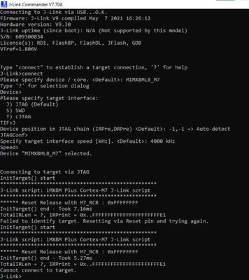

1.) Error While using J-Link Segger Commander tool to detect the IMX8M:

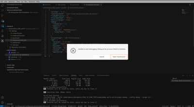

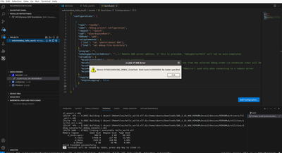

2.) Error while using VS Code with J-Link Extension and SDK Downloaded:

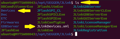

Also, I copied J-Link Patch file at following location:

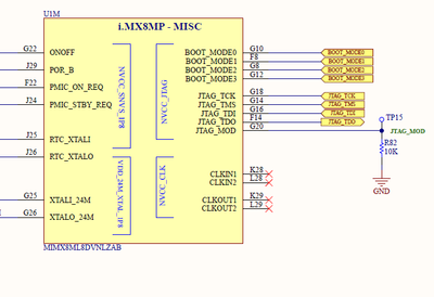

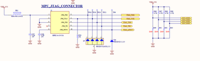

Below is the attached Schematic for our Custom Dev Board for J-Tag:
