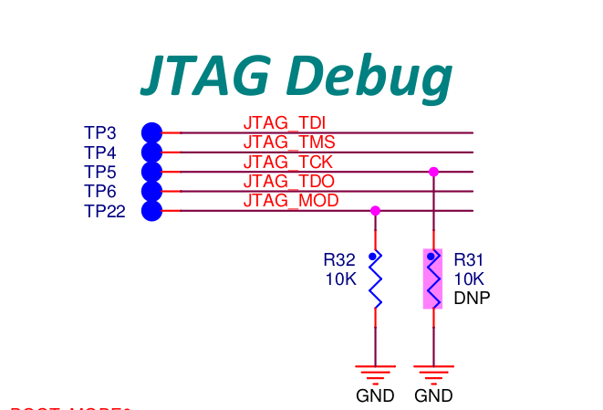

Dhruvit
Hi @SegFault0,
I hope you are doing well.
Is the JTAG_MOD pin pulled down by a 10K ohm resistor?
Thanks & Regards,
Dhruvit Vasavada
3,885 Views
SegFault0
Which pin are you referencing when you talk about the JTAG_MOD pin? The pin is not listed in the schematic I sent you neither is it listed in any other schematic.
3,863 Views
Dhruvit
Hi @SegFault0,
Please refer to 8.1.1.1 Muxing Options in i.MX 8M Plus Applications Processor Reference Manual for JTAG_MOD pad.
One can refer to i.MX8MP EVK reference design schematic for more information.
i.MX 8M Plus LPDDR4 EVK Compute Module Design Files  (sheet 8 of SPF-46368_A3.pdf)
Thanks & Regards,
Dhruvit Vasavada
