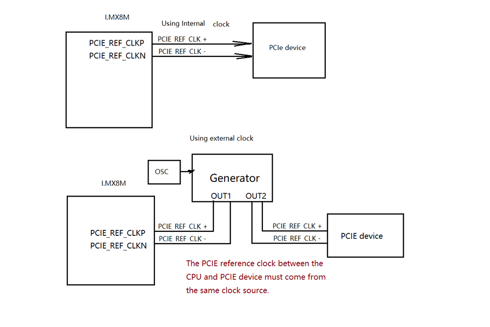

Hi,igor:
I have the other issue about iMX8M PCIe application.
The PCIe_1 Bus use the CPU internal PCIe clock. But device(BCM56160) use the external clock from 9FGV0441AKLFT(meet PCIe Gen1/2/3 clock chip). PCIe_1 Bus can work normally. But for a long time(several days or perhaps several weeks), software show a amount of errors on the PCIe_1 access. Maybe that finally will lead the  PCIe_1 Bus link down.
I want to know the root cause for the issue. Do this problem occur because PCIe clock of two sides isn't  the same source?
Do you know the similar issue? Share your experience.
Thanks!

weidong_sun
>>If iMX8M's PCIe_A interface use its internal clock, but the PCIe device use the external clock. After working for a long time, whether or not the PCIe_A bus will have a amount of error because of different clock source?
This hardware design is incorrect, which means that the PCIe controller and the PCIE device use different clock sources, which cannot guarantee data synchronization. Therefore, you will find a lot of errors in PCIe transmission.
Have a nice day!
weidong

5,150 Views
weidong_sun
Just drew a diagram for you. see below, please!
Hope it is helpful to you.
Have a nice day!
B.R,
weidong
5,146 Views
calf
Hi, Weidong:
Do you have the similar issue on other customers?
BRs
calf
