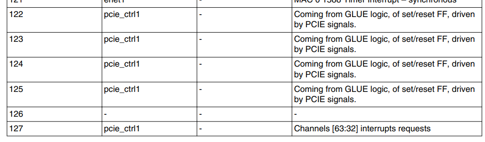

Dear experts,
May I know what resources are avalable to the Cortex-M4 core in iMX8M mini SoC?  I mean DRAM memory ranges and peripherals? For example can M4 access PCI devices?

Yes, you can consult it in table Table 7-2. CM4 Interrupt Summary of reference manual:

So can this CM4 receive interrupts from a PCI device?
yf
1,178 次查看
JorgeCas
