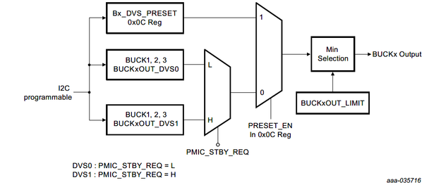

We are using iMX8M Mini in our project which is powered up by PMIC PCA9450AAHNY and we are facing issue with boot up.
The difference we observed between the boards which are booting up properly and the ones which are not is that, the former boards are getting expected voltage at VDD_DRAM rail, as per values set in register, of 0.95V from PMIC (BUCK3) whereas the ones which are not booting up is sourced by 0.85V from PMIC (BUCK3) which is default value generated by PMIC (BUCK3).
We're using LPDDR4 at 1.5GHz (DDR clock) frequency which requires typically 0.95V hence we doubt that since it is not getting required power it is hindering booting process. We suspect that patch from SDK for PMIC provided by NXP is not executed
Below is the part of SDK implemented for BUCK3:
/* BUCKxOUT_DVS0/1 control BUCK123 output */
 pmic_reg_write(p, PCA9450_BUCK123_DVS, 0x29);
/* Also, set B3_ENMODE=2 (ON by PMIC_ON_REQ=H & PMIC_STBY_REQ=L) */
 pmic_reg_write(p, PCA9450_BUCK3OUT_DVS0, 0x1C);
 pmic_reg_write(p, PCA9450_BUCK3CTRL, 0x4A);
It would be great if anyone can guide us through this and help with possible solution for the same or suggest if any changes are to be made.

AllanAn
Hi Zeel,
BUCK3 output logic is shown as below, I have checked your I2C command, it is OK to configure BUCK3 as 0.95V.
so I suggest to check:
Whether I2C command has been configured to PCA9450AA successfully or BUCK3 voltage configuraiton changed afterwards.
  1. read back the register for confirmation,
  2. Configure BUCK123_DVS as 0xAB to see if BUCK3 follow Bx_DVS_PRESET configuration.
if the 2 action did not valid, please check external hardware connected to see if BUCK3 voltage is affected by external componts.
Brs
