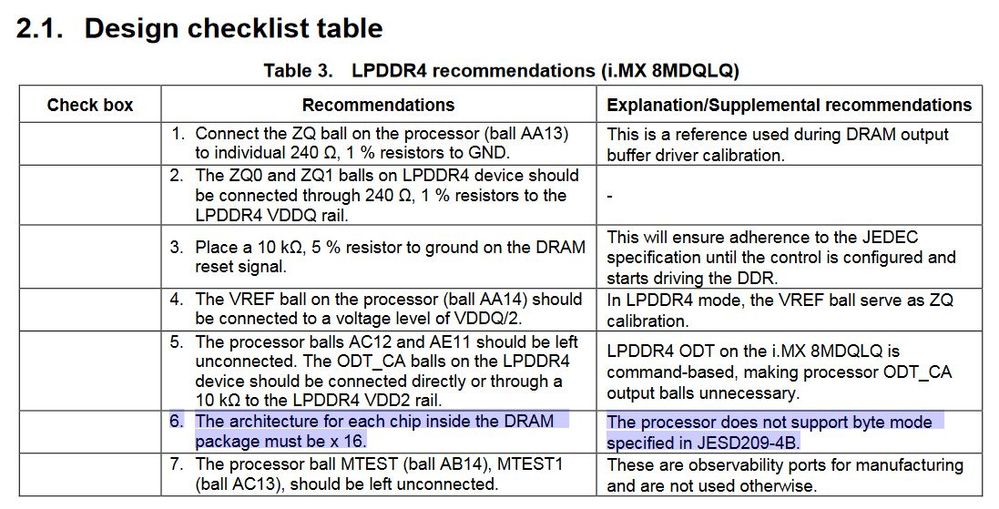

Hi, Thanks for the info. I'm trying to decide which memory to use to design the iMX8M-Mini with 4GBytes RAM. I can only find x32 4GB parts that are QDP(quad die package) which the iMX8M-Mini doesn't support. The largest DDP (dual die package) LPDDR4 i can find is 2GB. What RAM configuration would you suggest i use to get 4GB RAM please?

Hi, The iMX8M-Mini doesn't support QDP (Quad-Die, Dual-Channel, Dual-Rank Package) and the only 4GByte parts including the one you have mentioned are QDP. In that same datasheet the 2Gbyte part is DDP (Dual-Die, Dual-Channel, Single-Rank Package). I think we are going to go with a single chip 2Gbyte part design and hope a DDP 4Gbyte part is available in the future. Thanks for your input.

Hi Felix,
I've just found this is an old email from one of our distributors, maybe he was wrong?
Please note that
MT53D1024M32D4DT-053 WT:D – 200ball VFBGA FBGA – DID Z11M
SDRAM 32Gb LPDDR4 1GX32 1.1V .- 1866 MHz – QDP
Is not supported because i.MX 8M Mini does not support byte mode which is required for quad die package (QDP) dual channel dual rank
Supported (JESD209-4B ) is dual die dual channel single rank (=32bit) and single die single channel single rank (=16bit) with x16mode

I wonder why you think that byte-mode would be a requirement on QDP LPDDR4?
Generally all LPDDR4, including the QDP ones, are running 16 bit wide per channel as a standard.
Operating the LPDDR4 components in byte-mode is just an optional way that the LPDDR4 memories allow, but the i.MX8 does not support it anyhow!
Thus I think you mixed something up.... there is no byte-mode-requirement for the i.MX8. In contrary, byte mode can not be used with i.MX8.
i.MX8 supports maximum 2 Chip Selects (=ranks), 2 Channels, 2 CKE.
Note: There are seperate pins for each channel's Chip-Select and CKE --> CS0_a, CS0_b, CS1_a, CS1_b  and same for CKE. So some people might misunderstand this as 4 CS and 4 CKE
