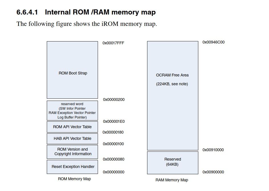

This is a user problem reading + understanding manual:
The figure says 224 is free  (  = 128(EPDC) + 64(128 - 64res) + 32(PXP) ), and "see note".
In note:  "The entire OCRAM region can be used freely post boot. ... "
So can the entire OCRAM 288KB be used freely post boot, or only 224?   (I can't say why I can't understand the doc ... ).
And if the 64KB is still reserved, what is it reserved for  .. (is it secret :smileyhappy:) ?

 The entire OCRAM 288KB be used freely post boot.

Hello Yuri!
Do I understand correctly, that I can't use adresses 0x00900000-0x0090ffff for storing my Cortex-M4 firmware because this range is reserved by Linux kernel and is used by it during boot process?
As I see from FreeRTOS linker scripts - they all use 0x00910000 as a start address. I tried to edit default linker script to use first 0x00900000 and then 0x00901000 adresses as a start address along with disabling corresponding ocram entries in the devicetree, but I see that my M4 firmware stops working right after kernel starts booting.
I use imx-5.4.47 kernel
My modifications:
imx7d.dtsi:
		ocram: sram@901000 {
			compatible = "mmio-sram";
			reg = <0x901000 0x1f000>;
			clocks = <&clks IMX7D_OCRAM_CLK>;
+           status = "disabled";
my devicetree:
	reserved-memory {
		#address-cells = <1>;
		#size-cells = <1>;
		ranges;
		m4_reserved: m4@0x00901000 {
			no-map;
			reg = <0x00901000 0x1f000>;
Did I miss something?
Thanks in advance.
