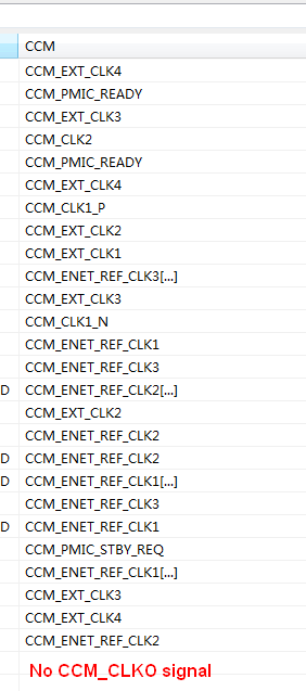

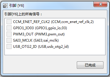

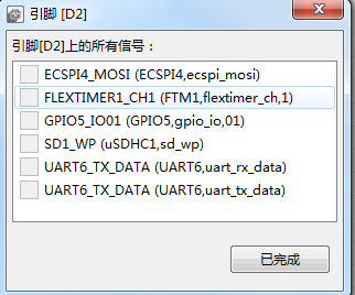

I see, CCM_CLKO2 can select OSC_32K clock source by configuring CCM_TARGET_ROOT register. But I don't find the CCM_CLKO2  pin of MCIMX7D3EVK10SD.
From table 5-10, IMX7DRM , the CCM_CLKO2 signal is at GPIO1_IO03 and SD1_WP. But I don't find the CCM_CLKO2 signal in PIN D2 and Y6 by Pins Tool V4.1. Please see attached photos.
So can you help me confirm it?

igorpadykov
muxing options can be found in sect.8.1.1.1 Muxing Options
i.MX7D Reference Manual
http://cache.nxp.com/files/32bit/doc/ref_manual/IMX7DRM.pdf
igor
