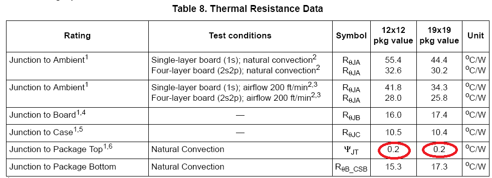

The total power consumed by our product is 1W (Max). As per the datasheet specification the Junction to Package temperature is 0.2'C/W (shown in below table).
pastedImage_9.pngThe expected temperature difference between the Die temperature and the Temperature on the processor package must be 0.2'C (for our case). But from  table.1 it is clear that the difference is too large.

Hi Yuvaraj
suggestions for controlling chip temperature are provided in
AN4579 i.MX6 Series Thermal Management Guidelines (also valid for i.MX7)
https://www.nxp.com/docs/en/application-note/AN4579.pdf
As processor operates at 60'C ambient temperature, it temperature will be
higher by "Junction to Ambient" factor using Table.1 (upper two rows) .
In Linux Thermal driver handles processor temperature, it is described in
Chapter 25 Thermal Driver attached Linux Manual.
