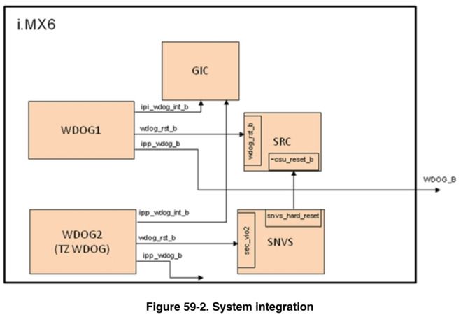

Hi Alejandro -- the devicetree configuration in your post configures the external reset pin, to be used with an external PMIC.  In our implementation, we do not have an external PMIC, and are hoping to use the second watchdog with the internal GIC and/or SRC to reset the system.  This works fine with wdog1, but I know wdog2 is connected to the SNVS and not directly to the SRC.  Is it possible to configure the SNVS to pass the reset through to the SRC by default?
4,489 次查看
fas3
Because watch dog 2 is trust zone watch dog.  You have to use hardware method. Configure  the LCD_VSYNC pin as WDOG_B.
You can check the i.mx6q Sabresd  schematic.

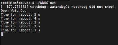

I made a little C program to test WDOG2 with 5 seconds of timeout, I will attach it.
To run the test:
Copy the WDOG2_Linux_Test.c file in your imx6 board.
Then compile it with:
$ gcc WDOG2_Linux_Test.c -o WDOG2_Linux_Test.out
And run the WDOG2_Linux_Test.out file
$ ./WDOG_test.out
If all it is correct, you will have logs like:
(I made with imx8mm but it should works for imx6 too).
I hope this can helps to you.
