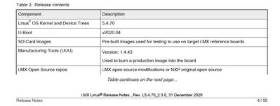

> The same U-Boot code was working with Kernel 4.1.15 ..
that uboot  (which was working with Kernel 4.1.15) should not be used for Kernel 5.4.70.
As described in NXP Linux 5.4.70 official Release Note document included in Documentation
Uboot v2020.04 should be used
igor
