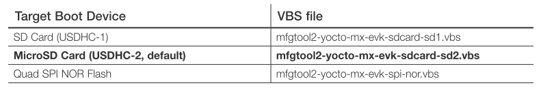

The iMX6UL-EVK contains 256Mb QSPI Nor Flash. In Serial Download Mode, choose mfgtool2-yocto-mx-evk-spi-nor.vbs to open mfgtool(3.14.52), but found error:
U-Boot 2015.04-imx_v2015.04_3.14.52_1.1.0_ga+g6cf684a (Dec 05 2015 - 02:09:52)
CPU:   Freescale i.MX6UL rev1.0 at 396 MHz
CPU:   Temperature 41 C
Reset cause: POR
Board: MX6UL 14X14 DDR3 ARM2
I2C:   ready
DRAM:  1 GiB
force_idle_bus: sda=0 scl=0 sda.gp=0x3 scl.gp=0x2
Can't find PMIC:PFUZE100
initcall sequence bff92d60 failed at call 87802e90 (err=-1)
### ERROR ### Please RESET the board ###
Dose iMX6UL-EVK support to boot from QPI Nor Flash?

mfgtool2-yocto-mx-evk-spi-nor.vbs  is for spi, for qspi please try
mfgtool2-yocto-mx-evk-qspi-nor-n25q256a.vbs

No "mfgtool2-yocto-mx-evk-qspi-nor-n25q256a.vbs" file in the directory. I found "mfgtool2-yocto-mx-sabresd-qspi-nor-n25q256a.vbs", but also got the error.
In page 12 of "i.MX 6UltraLite EVK - Quick Start Guide .pdf", "mfgtool2-yocto-mx-evk-spi-nor.vbs" for qspi nor flash.

The newer mfgtools - L4.1.15_2.0.0-ga_mfg-tools does have mfgtool2-yocto-mx-evk-qspi-nor-n25q256a.vbs.
