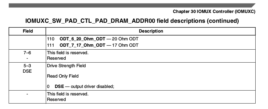

For the iMX6UL, why is the drive strength (DSE) setting for DDR ADDRn pins in IOMUX read-only?
For example, see the IOMUXC_SW_PAD_CTL_PAD_DRAM_ADDR00 section of the reference manual:
I would have expected the DSE bitfield to have a variety of configurable options, since ADDR is an output of the iMX6...  But instead DSE is disabled and read-only.

Hi Nick
these settings are configured by SW_PAD_CTL_GRP_ADDDS SW GRP Register
(IOMUXC_SW_PAD_CTL_GRP_ADDDS), described in sect.30.5.288 i.MX6UL
Reference Manual.

Thanks, I was not aware of that register
