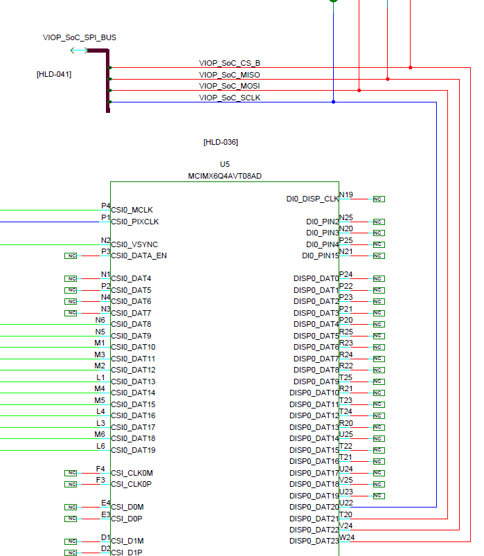

Does anyone test the boundary scan of iMX6Q? The BSDL file seems not correct. I tested the CAPTURE-IR, IDCODE and boundary scan chain length, all correct. But when I want to control a pin through boundary scan chain, the pin does not have expected response. My board has a iMX6Q with mark MCIMX6Q4AVT08AD.

But the problem is not only EIM port signals. On our board, iMX6Q has an SPI interface communicate with another boundary scan chip ( a PPC MCU), these signals can be tested by boundary scan. The schematic of the interface is below:
When I trigger output from the opposite chip and sample responses on iMX6Q, I can not get expected value.

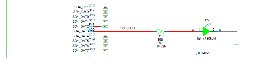

I try to verify the BSDL by control another iMX6Q pin as output, A20, I also can not get the expected state on the pin. This part of schematic is below:
So the problem is not related with the EIM ERR009218.
Do you have any other information about the boundary scan test of iMX6Q? Thank you very much!
