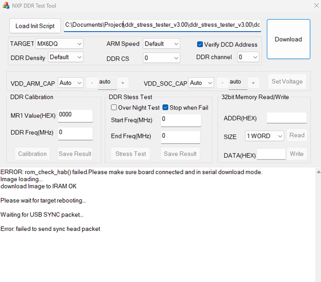

We are attempting to use the DDR Stress Test Tool to update an iMX6Quad processor. Our CPU is the MCIMX6Q5EYM10AE and we have two MT41K256M16TW107-IT DDR3L devices connected. When we run the DDR Stress Test Tool, we get the following error message:
We are unsure what the "Error: failed to send sync head packet" message means, which is preventing us from debugging this issue.
Can you explain where this error message comes from?

The tool is not able to connect with your board.
Please confirm that you board has both USB cables connected (USB data and debug).
Verify that your board is in serial download mode.
Do you have your board configured with secure boot?

zb2020
The board is in serial download mode and is not configured with secure boot.
The USB OTG cable is connected, but I'm not sure what you mean by "both USB cables connected (USB data and debug).
We are also seeing the USB error in U-Boot when trying to load U-Boot via USB:

We encountered this error after switching the processor from the iMX6DL to the iMX6Q on our custom board. The board with the iMX6DL passed the memory test successfully.
Is there any difference in the USB hardware configuration (USB OTG) between the iMX6DL and iMX6Q?
