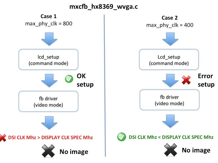

Hello community,
I attached a image showing two test case using a MIPI-DSI display with an iMX6Q.Diapositiva1.jpg
  • Case 1: using a clock frequency (according with the variable max_phy_clk included in the file mxcfb_hx8369) of 800Mhz, the LCD setup function is OK. In fact, the communication in command mode with the LCD is great. Later, when the DSI mode change to video (using fb) the frequency clock (in CLKN and CLKP) is bigger than the display specifications. So, I think that this is the problem.
  • Case 2: reducing the clk frequency to 400Mhz (again with the variable max_phy_clk), the LCD setup function is not OK. The communication with the display have problems (in command mode).
I would like to change the mipi-dsi driver to adjust a different clock for command mode and another for video mode. However, that's is impossible without the data sheet that explain the DSI module. I didn't find that.
If somebody have other ideas, don't hesitate to share it.
JC

juliocruz
I found the MIPI-DSI specifications and figure out the modification. I adjust the register: TX_ESC_CLK_DIVIDSION and now the clock in command mode is OK (independently of the video mode).
