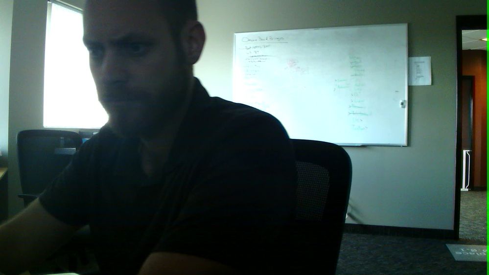

I have a program that will capture camera frames at 1080p UYVY, use the IPU to convert to YUV420.
I have noticed that if I have the IPU output 1080p, there are green lines in the image.  If I use the IPU to do color conversion AND I downscale the image to 720p, there are no green lines.
See attached image for an example of the 1080p green lines.  There's one right in the middle and one way down at the bottom.
Any suggestions on how to fix this would be appreciated.

Thank you for the response.  I recently discussed this with a colleague who informed me that he had adjusted the calculations in the linux/drivers/mxc/ipu3/ipu_calc_stripes_sizes.c folder.    I reverted the changes back to the orignal code but ended up with a different green bar.
Also, I took the ipu examples you linked above and modified the csc to do my color conversion at 1080p and 720p.  You can see that there is a green bar on the right side of my 1080p image which is not present in the 720p image.  Since this green bar was in a different orientation with the the modified ipu_calc_stripes_sizes.c code, I'm left with the assumption that the stripe sizes aren't calculated correctly for 1080p.

EDIT:  Also worth noting, when I use gstreamer to capture a video at 1080p there are no green bars
$gst-launch-1.0 imxv4l2src num-buffers=30 ! queue ! imxvideoconvert_ipu ! vpuenc_h264 ! queue ! flvmux ! filesink location="encoded.mp4"

Made a discovery:  gstreamer prefers the NV12 color format over the I420 color format.  When I force gstreamer to do I420 the green bars are back.
I modified my csc_ex2 code to output NV12 and the green bar is gone.  There seems to be an error in the IPU conversion for YUV420 at 1080p.
